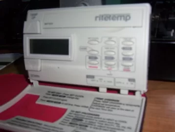

I have an extra Digital thermostat by ritetemp.. Model 8022C. It does say 24VAC and MV.. But you have a choice of selecting Electric or Gas. what would you select if this would work.Or does ritetemp have one for a pellet stove.I have never used this, so maybe i have one and didnt know it.

Rick, as we've mentioned above, you need a millivolt stat, not a 24v one, so it has to be configured for that. As for the electric or gas setting, my guess would be gas, but you might want to call the company and ask.

If you read my last post it says 24 volt and MV whiich i believe means, Millivolt.. But i want too make sure,.. don't want to ruin the PC board.
