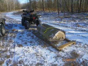

    It might work but with that small diameter and 40" it would seem easy picking for many. I'd probably try leaving them 80" or even 10'.

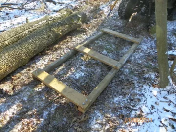

    On the cutting and dragging, if you drag those logs they will get lots of dirt on the logs which your chain saw will not like at all. Not only will you be sharpening often but you will wear your chain out fast. I'd suggest building a small dray. That is what we did when we wanted to haul out some logs. The dray pictured below cost me around $10.

    thanks! that drag looks good and functionable. good idea

    Well, it is a dray rather than a drag and it is indeed handy. Only takes a very short time to put it together too. I used some old landscape timbers I scrounged from a neighbor and the 2 x 6 were just some short cut offs we had. So I had to buy some bolts to put it together and 2 eye bolts for strapping the load on. It is amazing how easy it pulls too.

    Dennis - the more I see that dray posted the more I think I need one. I have all the components to fab one up so I just need to find the time. I won't be needing it until my serious cutting season starts again next winter so I have time :) I think there are some places and in particular, some logs, that a dray would just be darn handy!!

    Thanks Bob. It comes in pretty handy for many things besides hauling logs. Hey, it even works great for moving deer blinds. Want to have some fun? Tie a rope or ropes to the front and have someone ride so his feet are on the back of the dray. Snow or ice will give a really wild ride!
