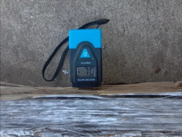

    This is a 3-4" white oak round that has been on top of a stack for two summers, about 1.5 years. The gray on it is a small crack/split about a quarter of the way thru.
    That HF moisture meter reads up to 40%, I believe, then shows over limit.

    It really is that high still after 1.5 years. That's amazing. I would think it would be in the mid 20's.
