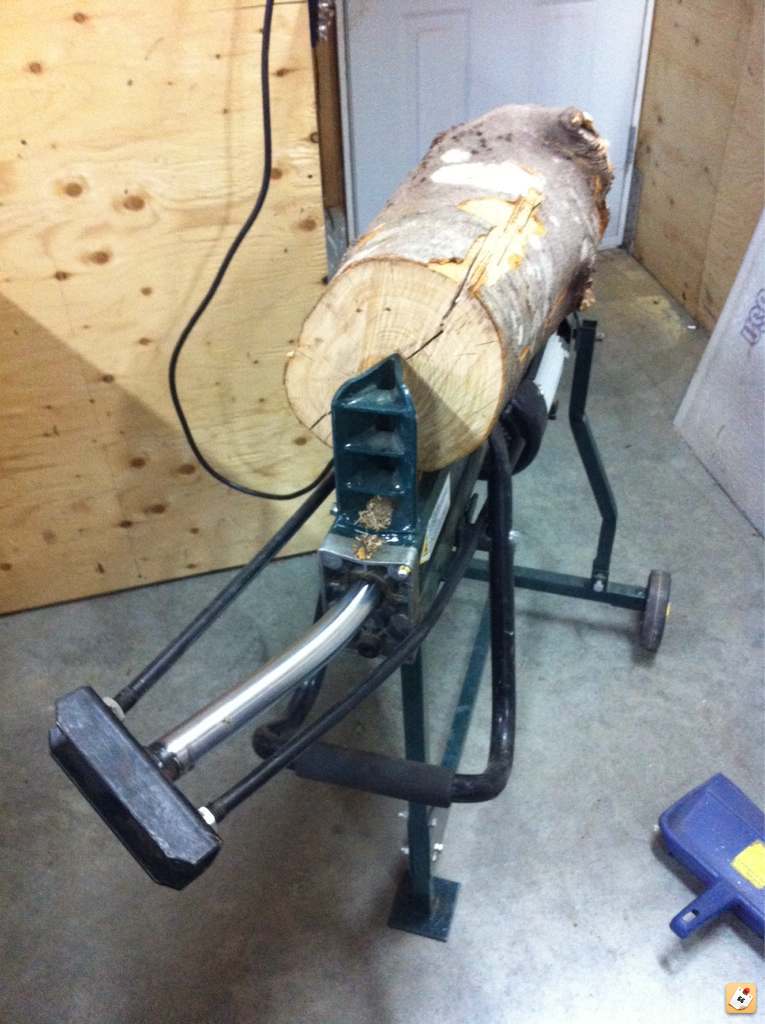

    [​IMG]
    She said it just happened so fast! Lol

    I'm looking at it funny, is it supposed to look like that?

    No the piston is bent. She tried to split a piece of dogwood . You would think the relief valve would open first though

    Scratching my head. Did the pusher come off the other end?

    No pusher is still on. took some effort to get the round of wood out .

    The "pull" rod on the left side had to become disconnected in order for this to happen, No?

    I real liked the splitter though, you could stand up while splitting . was going to try and set up some sort of foot pedal on it. didn't like that your hands had to be on
    Yes , the pull rod snapped off at the weld connecting it to the splitting end bracket. must have been made in China.
