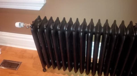

I went out today and picked up a couple of Danfoss TRV's. The problem is that they look like crap on my old refurbished cast iron radiators. Has anyone seen any that would suit the style better ?

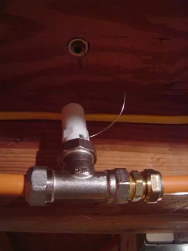

I will say I am such a huge fan of constant circulation and TRV's that I'd be willing to trade some aesthetics for function. I went with capillary tube TRV's with my infloor heating.

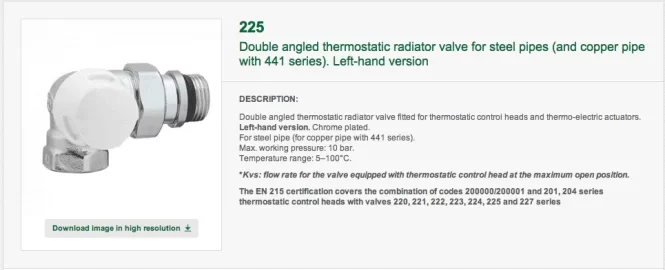

Yeah that is sort of a tall head. There are some double angle valves like this, in a right or left hand version. It would put the actuator to the back, or front instead of out the end.
I'm not sure how available they are in the US market.
How many are you looking for?

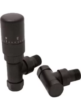

Bob's recommendation of the double angle valve would look good, especially with TRV like this:
TRV styles
EDIT: that pic is from a UK site and may not be available in NA and it's $$$

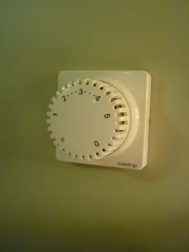

Thanks Floydian. I have the capillary one on my radiant floor also. I don't know why I did not think of them for my rads. It could work on my main floor as I still have access to the underside through my old basement. I assume I would mount the dial on the wall and then run down to a valve just below the rads. I don't have that kind of access upstairs so I may need to go with TRV's right on the rads up there. Would it matter how far the trv is from the rad if I put it underfloor. It is really just a zone valve so I would think not.
I saw the black ones you show but I think they are over $200 each and most likely would have to be shipped from the UK. I don't have time for that. Winter is coming.
I like the style you show too Bob. I would need 8-10 of them if I put them everywhere. Who makes them? I wonder if they come in black. Cheaper than Capillary ones?

Perfect. Thanks lads. I think I will go with the capillary ones, at least on my main floor. I will have to see how much access I have for the upstairs ones.

I used the same ones,i looked for a while and didn't have much choice up here.
I see we have the same taste in boiler/storage,and color of rads.My wife is from Ottawa,have a friend the moved to Brockville.Small world.
I will dress up the tops of the rads with some scrap stone from a stone cutter i know,that will hide the TRV's a bit.
