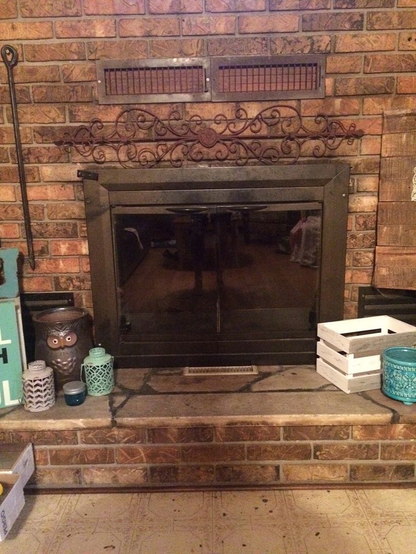

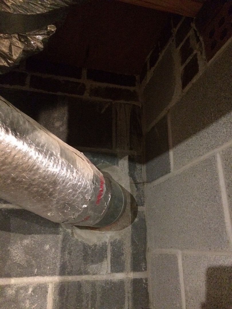

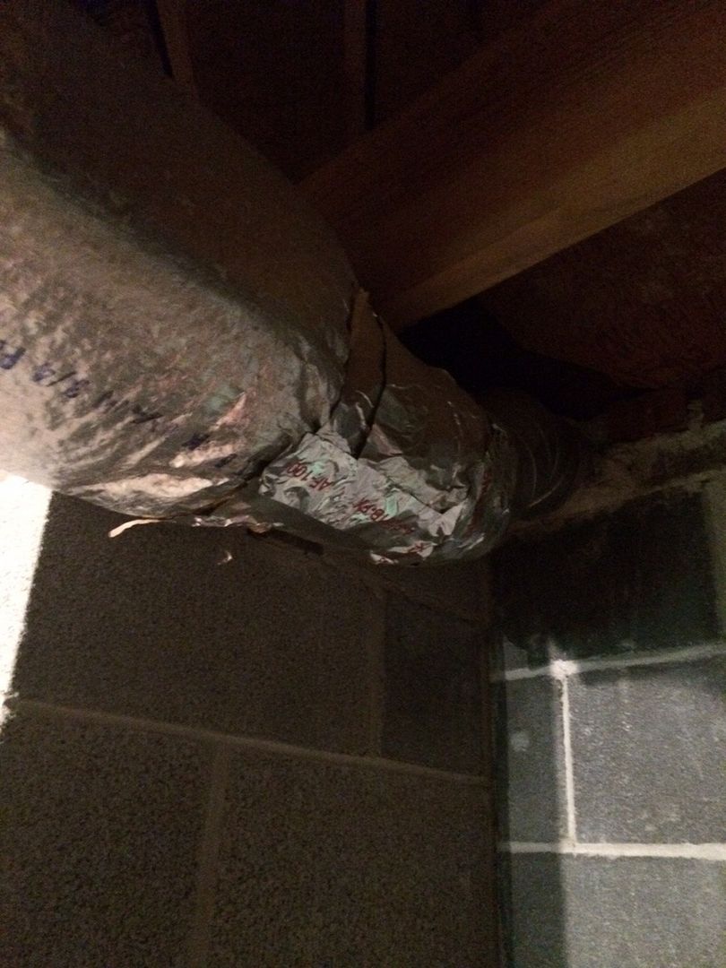

Now, the current setup. 33"w x 24"h x 24"d fireplace with 1/4" steel plates welded in to make a box, and ~8" clay lined exterior chimney (about 15-20 ft). The fireplace has 2 240v heat pump style blowers with two separate intakes on the hearth. Two outlet vents above the fireplace allows the air to be blown into the living room. Here is where things get a little different. The vents above the fireplace can be closed, causing the air to be forced through the duct work in the basement. Each room in the house has 1 vent in the floor connected to the fireplace. Also in the basement is a giant ash dump directly under the fireplace.
My chief complaint from this set up is the same as most...too much heat up the chimney and too much wood being burned. It's borderline amazing how fast you can blow through wood.
The obvious answer is to throw in an insert and stainless liner and call it a day. However, given the setup, is there any way to capitalize on the HVAC style system hooked up to it, or will an insert alone be enough to cover 1,300 sq ft.? Also, do you bother with cutting out the old steel plates (not knowing what is behind it) for extra space or leave it be?
...got a few ideas, but I'd like to see what the general consensus is before I start hitting on specific models.
Thanks in advance for the help...and for the knowledge already gained from this site.
Here are a few pics for reference. The wife covered the intake vents with decorations after we quit burning this spring.
IMG_02771_zpscryzathy.jpg~original
does that grate suck air form in front of the firepalce?
Put a ninsert in there and forget about all that other crap. And no don't cut out anything unless absolutely necessary to fit the insert

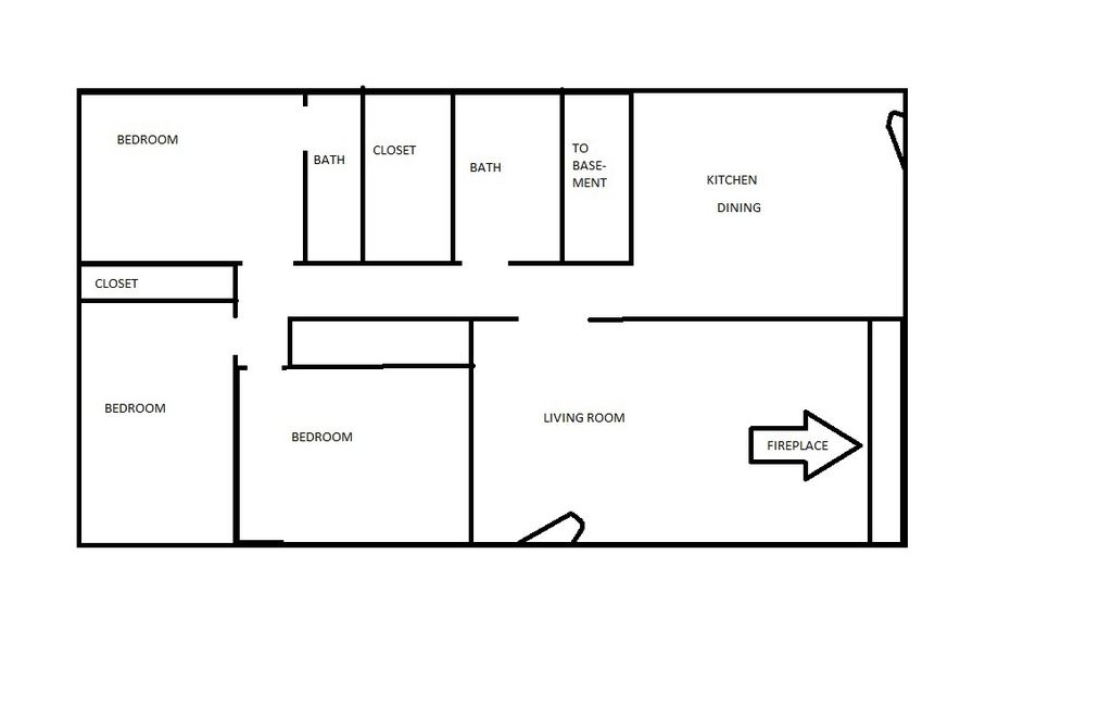

Heat-wise: Yes. A larger medium insert (~2.5 cu ft) installed with a block-off plate and fed dry wood should easily heat 1300 sqft in your climate. The question is: Can you move the heat around your home? Can you post a rough sketch of your floorplan?
And I would think about closing off those ducts maybe by stuffing some Roxul insulation in them.
I think it is supposed to, but I have never had any luck with it. It must be stopped up somewhere, but I'm not sure where the other end of it is.
I don't think moving the heat around will be too big of a problem. If I can get this set up hot enough, it seems to spread decently. I'll have to sketch out a floor plan when I make it to a computer. Every fan but one has a ceiling fan and all the ceilings are 8 ft.
Would I be able to use the existing duct work with an insert to move heat around? Or should I just scratch that thought?
Below is a rough sketch of the floor plan. Every room has ceiling fans except the bedroom with the bath attached...we usually shut the door to that bedroom anyway as its a guest room.
Moving the heat hasn't been too big of an issue in the past..just not enough heat in the first place.
