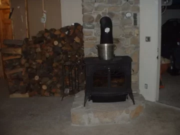

SO the old beat up, worn out 1984 VC Encore is gone & the freshly rebuilt 2005 VC Defiant is up & running. Last night was the first night with it going. It was in the single digits last night. WIth my old stove I would have around 78 degrees in the basement, 74 degrees in the middle of the house, & 70 to 72 out in the bedrroms on a night like that. In the morning at 5:00A when I get up the house would be getting chilly & there would only be coals in the stove.
So last night it was only 68 in the bedrooms & 70 in the main part of the house. Around 75 in the basement. I woke up this morning & it felt VERY cold in the house. Checked & it was 65 to 68 in the house. The basement was only 72 & the fire was just coals. It's been 1-1/2 hours since I got it going again & I got to say I'm a bit disapointed so far. I set a steamer on the burner top last night & it never even boiled off the water. I can be withing inches of the stove & it isn't to hot for me with a flue gas temp of 500 to 600 degrees. On the old junker you wouldn't be able to get with 1' of the stove without it being so hot you had to move. A gallon of water would almost always boil off over night. In the morning it would still be warm in the house.
So I am using MORE wood now & getting like half the or 2/3 the heat I used to get.
Also it seems like more smoke comes out when you open the door on this stove. My old stove kept all the smoke inside when you opened the front or top door.
