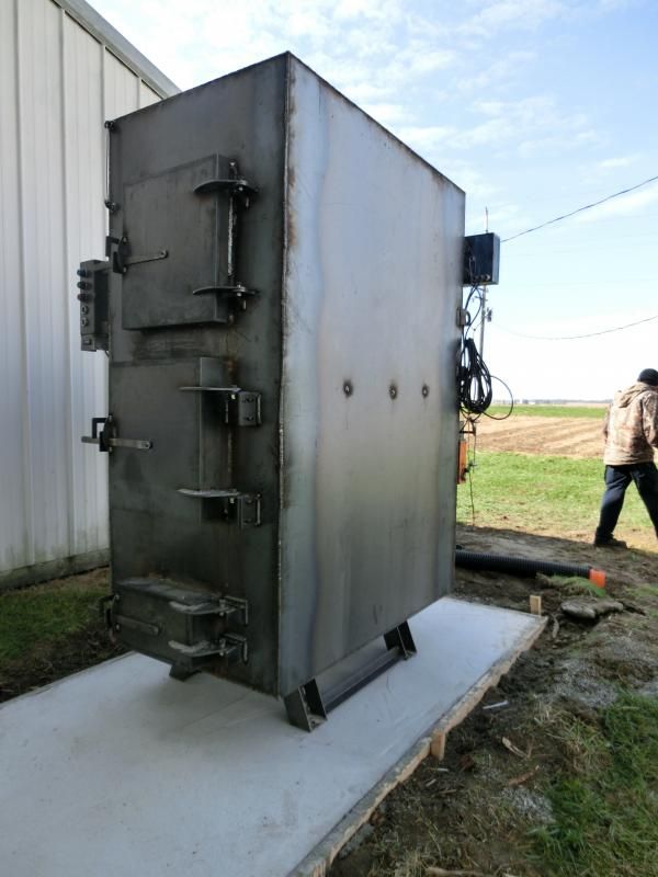

Just thought I'd post some random info and thoughts about my new wood gasser.
Its been 2 weeks now since my first fire, things seem to be going well. I picked up some brushes and rod and put together some cleaning tools for the pipes, and gave the second/third pass 2" tubes a brush down. They had a decent amount of flaky ash hanging on them. The SS brushes cleaned them spotless easily using a drill.
I also cleaned ash out of the secondary burn chamber for the first time. I got about a gallon bucket sized pile out of it. Very minimal ash for 2 weeks of burning, was interesting to see the ash was burnt down to a near solid form, and raked out in chunks. I'm sure this is common with all gassifiers, just new to me.
I inspected all doors this morning after the sun was out, and everything looks visually good to me. I grabbed a temp gun, and found as I had expected, my temps are pretty low at the stack exit. Around 150, but that was after starting a burn and not quite gassifiying yet. I doubt it would go up too much though. I was only getting 230-250 ish at the vertical first pass tubes at this point.
I'm really enjoying the burn times, I'm able to load moderately and make a 14 hr timeframe with a large coalbed to load on afterwards. The weather has been much colder than typical, night temps dipping to 10-15 degrees. The stove cycles around 3-4 times during a 14 hr period in these temps. I've yet to notice it cycle 5 times between loading. With the amount of water it holds, even if I don't load at 14 hrs, the house won't notice for what seems another 4-8 hours atleast. Sure beats waking to a cold house to build another fire, or coming home to a cold house after being gone for 4-6 hours.
I will say, I'm already daydreaming of building another, Although at this point its too early to tell what I would want to change to make it better. I would like to make a much much smaller version I know, would be much less trouble handling it and alot less material too.
A pic of the boiler for those who didnt see my build thread- before it was covered and insulated

Very impressive work. I followed the build from your other thread.
No, I haven't done much in the way calculations yet. Now as most of the work is done I'm starting to get interested in it, I'd have to look up how.
Sound like the Bug Bit you....there is something about fire and water that is addicting...the entire process holds your attention, and not paying for oil every month is pretty nice..I followed you build, very nice work, both design and execution......you should be proud of that beast....can't wait to see what you do next....
