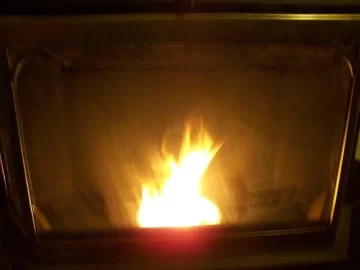

So I'm at a clients home today cleaning out two Whitfields, a P20 and a P30. After a very thorough cleaning of the P30 I start it up. OH NO! Smoke is pouring into the house. Quickly I grab the burnpot out with vice grips and bring it outside and then toss my shop vac in to the exterior clean out vent. I double check everything and start it up again. Oh No!! More smoke, but then the fire catches and it quickly escapes. Weird hugh?
So I go up stairs and clean out the P20, after a very thorough cleaning I start it up. OH NO!! smoke in the house. And a lot of it!! YIKES! Before I can move the burnpot out the fire catches and the smoke escapes....Couldn't figure it out.
