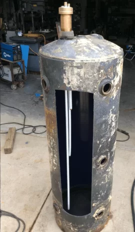

Yeah both double tapped and duplex bushings are handy for putting wells and dip tubes into tanks.
Here is a 4 well nipple I built for putting sensors at various levels in a tank. I used pex as the wells with a brass plug at the end filled with transfer grease.
I like the weed eater string idea, I sacrificed an old wire puller tape to cut pieces for the sensor removal.
Bob...
VERY NICE!!!
