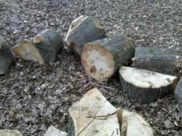

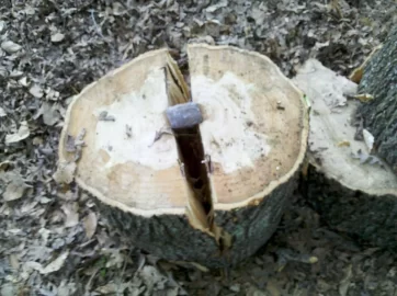

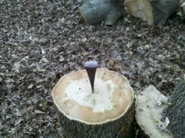

I was told it was water oak. I never tried to split something this hard before I hit the wedge five times and the next hit the log spits the wedge out. I finally got it but man this is nuts.

Not sure what that is but by the looks of that second picture, it splits well. No doubt after that first split, the rest should split easier. I never figure they are hard splitting until I get 2 wedges stuck with the log not yet split apart. :mad:
I know Norway maple is very hard to split, it could be that, not sure......
What I am sure of is that I think your wedge technique is not correct. You have that wedge in the center of the round...
Try placing it closer to the bark, preferably in a visible Ariel crack, hammer it in a bit, then use the 8 # maul to bust it open.... I know my Norway maple took 2 wedges at times....also a trick that I use is to make a 1/2 inch line with a chainsaw to start off the wedge in the wood so it doesn't spit out on you..... But remember, get the wedges closer to the ends rather than the center.....have fun pounding......

Looks like a maple to me! blurry pictures.......

Some guy on here last year had some Water oak he showed that he cut. I thought it might be a local vernacular for like swamp white oak but it is actually a species of oak.
Obviously a swamp type oak.
