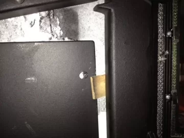

    Had a new Hearthstone Heritage delivered last week and while poking my head around in the firebox I noticed a wooden shim wedged between the door frame and soapstone sidewall. I'm guessing it was meant to hold the frame in place while the cement dried? It's wedged in there pretty tight and I wonder what's going to happen when it burns away.

    Nothing exciting. It was just keeping something from moving in transit. Bolted and cemented together there isn't anything going to come apart.

    Instead of a Wood Stove you have apparently purchased a Wooden Stove.

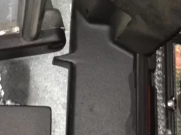

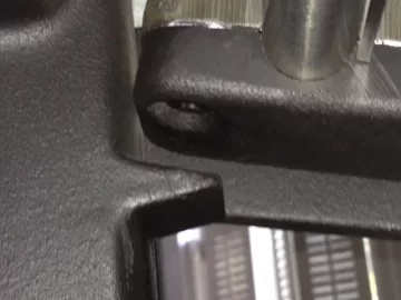

    Note that your secondary manifold is not seated onto the side column tab above the wood wedge. The whole stove is now suspect and perhaps was assembled by an asshat.

    Ok, I think I see what you're talking about but what does it mean to the operation of the stove?

    It means it was not assembled per plan and per the design. If you don't care whether the expensive stove you just bought is right then carry on, wood will still burn. Maybe not as well as it should but you'll never know how well it was supposed to work since the one thing that you do know is that your stove was assembled by an asshat.
    Is the manifold not seated on either side tab? The manifold only hooks to the rear of the stove with that single allen bolt and then rests on the tabs in front. It is a three legged horse design. If one leg is high then the opposite side of the manifold is low or the whole dang thing is tilted.
    Yes, I am serious about the assembler being an incompetent boob. You bought a premium stove and this type of error, along with leaving the wooden wedge, show a lack of QC as well.

  8. ridemgis Member
    Neither side is resting on the tab. I do think there's more than just that allen bolt in the back holding it up though. There are screws through the bottom on either side at the back parallel with the back wall of the stove. How difficult was it to make them fix it properly.

    The Wood Shim can also be used to start your first fire!

    The stove comes delivered fully assembled from the factory. I have inquiries in to both the dealer and Hearthstone. And I found a Hearthstone document that details replacement of the ceramic baffle. It includes a photo of the assembly clearly not resting on the tab. If this is really problem would they use it in their own technical docs? I've pushed and pulled on this thing and it's solid as a rock. I honestly don't know what to think.

    I looked at the same document and see what you mean. The secondary rack does not appear to sit on those cast stops in the pdf. Not having a Heritage on hand I can't compare. My apologies if this has been a misdirection.

    Oh no those tabs are there for the manifold to rest on and yes, the only thing holding the manifold in place is the tabs in front and the single allen bolt in the back. I have personally removed the entire manifold more than once.
    Other than generous amounts of cement, the only thing holding that manifold in place is the single allen bolt.

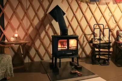

    I helped put in a 2110 in a friend's yurt. It's a fine little stove, very solidly built.

    It's definitely a smaller stove, but the OP indicated they want smaller. That Morso is about 1.1 cu ft IIRC. They also make a 3 cu ft model, the 3610. The yurt is a large one. with just foil bubble insulation. It needs heat, more than the average house, yet the 2110 does a decent job. Morso tends to publish more conservative specs than the average stove company.
    PS: The Morso 2110 is rated at 42K btus maximum. You won't likely be seeing that too often. Its heat output range is lab. tested at 8,136-39,990 BTU/hr.. FWIW, in practice I found it provided a longer burn time than our Jotul F3CB which is about the same size. The next time I'm up at the yurt I'll have to measure the firebox because it seemed to take a little more wood than the Jotul. That might just be the shape of the firebox allowed for tighter packing.
