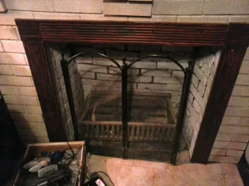

Sorry about the late reply and thanks for the help. Here is a picture:
[Hearth.com] What will work in a 32x32x12 fireplace space?
What's behind this picture? This is an exterior wall so there isn't anything but the rest of the chimney on the other side of the wall.
The home is quite old but I will have to get the approximate year. Carrying forward the alcove idea, if a hearth / hearth pad was built up and safety and clearances observed (yes, the wood trim would go), could something like this work?

That looks like a coal fireplace, that would explain the small size and the grate is for coal. The wood trim should not be there and was probably added later. There should be a damper and a smoke chamber above the throat. Even with the wood removed the side clearances may be a bit shy. Is there a wood mantle over the brick which looks to be just beyond the photo, if so that dimension needs to be known. If all masonry may be OK. May be suitable for a small stove. The other critical area is the throat and damper. That will determine how difficult or easy it will be to get a pipe/liner past.
