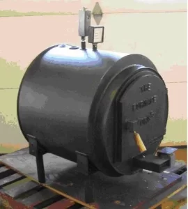

. From what I am reading they are the Cookie Monster of wood.LOL
Our first boiler was one of these, the basics of an OWB without the cute little house around it. You are right - a wood Cookie Monster at 22 cords per year.

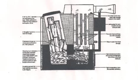

What would recommend
Our Jetstream Gasification boiler with storage 4 1/2 cords per year.
This was one of the first successful gasification boilers (1981)
