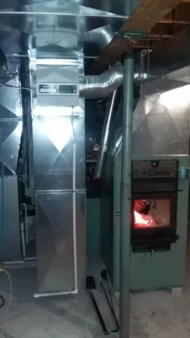

I have a Honeywell "HE120" attached to the cold air return of my wood furnace. It's just a simple flow-through style. It's attached to the water supply, so theres' no "babysitting".

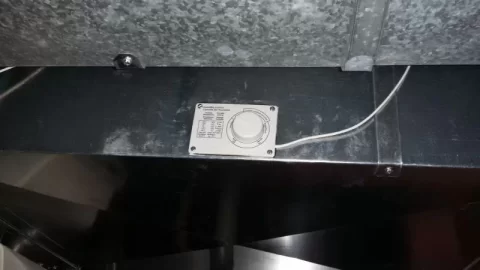

It has a simple dial that sit's upstream in the cold air return making it very easy to set. I have 2 temp/humidity guages in the house to keep an eye on it. I usually try to keep it between 30-40% for the winter, a little higher as it gets warmer. The humidifier has no problem keeping the humidity up, even when it's below zero for days.
