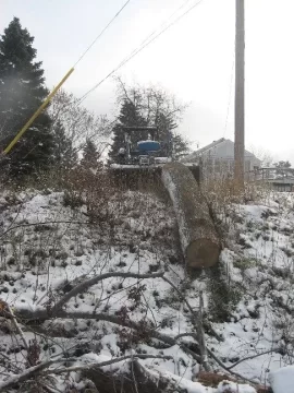

It depends on what you expect to get done with it. This is my test run. It pulls stuff like that up a bank but much more weight and it gets hot real fast.

It really depends on what it is hung up on and how big the tree is. My winch stops if the tree hits anything solid. I keep the 6' steel bar with me any time I am using it.
