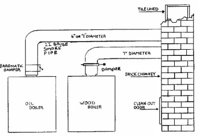

I am pondering a wood add on boiler to coincide with my current oil bioler. My question is, would I be able to vent the wood boiler into the same flue as my oil burner?. I have a masonry chimney with dual clay liners. One liner is in use for my Fireplace insert.
I found the attached diagram online from a boiler manufacturer which suggests they can be vented into the same flue with the wood vent below oil.
