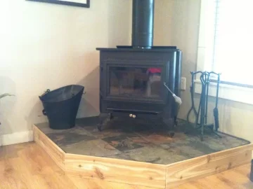

Hey rebel! Is that your 13 in your signature pic? Woo Hoo! Remember, no matter how much you want to use it this summer, ya gotta wait or else you'll be in the same category as the real old guys at deer camp...the ones that keep the fire going...about 80-90 degrees...overnight and everyone who is trying to sleep just melt instead.

Lol! I'm gonna burn it the next two nights cause its gonna be in the 30's here but after that I'm shutting it down! No that was my 17vl in the pic, I need to update it.
Wood seasoning time Here it is Dave! Still gotta seal my cedar up front but its pretty well done
