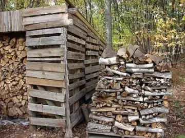

Blahh Drip edge ??? You dont need a derip edge with my wood shed..... Of course it cost me next to nothing to build my "Bayou Shack" as my wife calls it.

Shawney - what kind of roof is on that bad-boy?
All- umm- aaa- num . Just standard metal roofing sheets, that and a few PT 2 bys were the only cost on the sucker, everything else was salvaged or left over from other projects.
HaHa,
Hey neighbor. If I didn't know better I would swear there is a moonshine still somewhere back there. ;-P
That looks awesome! Can't beat the price. Me and free go back a long way. :cheese:

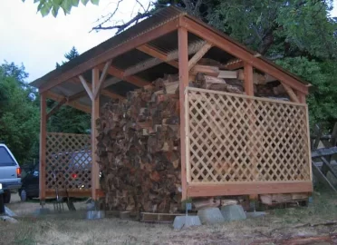

No OSB or drip edge here either. Besides good cover, I want low maintenance for the shed.
