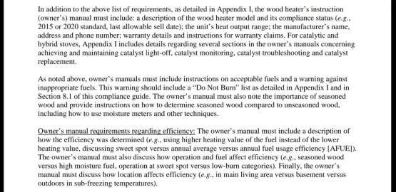

It doesn't call out HHV test specifically, just an approved one. I can't imagine there are several to choose from which one would offer better results over another.
I retract that. That was just the fact sheet summary. If you want to see the entire compliance document it can be downloaded here.
https://www.epa.gov/residential-wood-heaters/small-entity-compliance-guide-residential-wood-heaters
Here is a screen cap that is applicable.
In fact, I may be dreaming after the red eye, but I recall the full rule specifies that we are not to report other than HHV. Or "promote" may also be iin there.

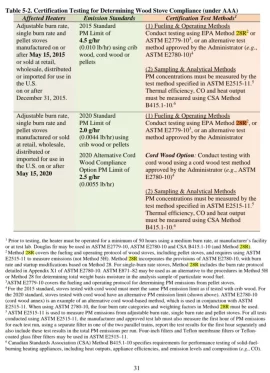

My copy of full rule on my desk...
B415.1-10 was originally the indoor forced air wood furnace method. Thermal efficiency are HHV. Glad to see someone is interested! You can see these reported numbers on EPA's website....no more defaults!
