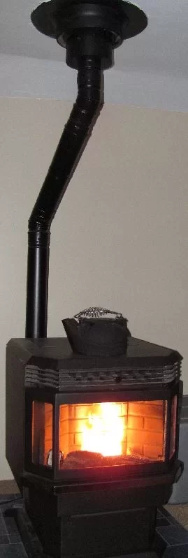

Shoot imacman a PM asking him. He has had 2 different stoves ran this way. His Astoria and his CPM. Both are in the Hearth Photo gallery. Look great with the venting the way it is. IMO
Here is one of them

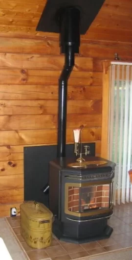

Here is my set-up. Been running since Oct with no problems.
