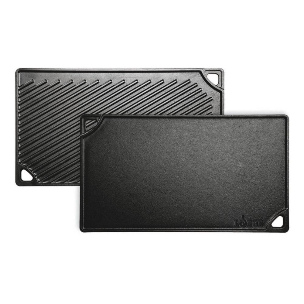

    i like where this thread is going. seems they could easily make something that slides in their for a pizza or calzone or something. lodge cast iron makes a pizza "stone" out of cast iron. i had heard rumor woodstock may be making a oven that sits on top of the stove, but that is only rumor. i asked. ha. imagine baking a pizza during a snow storm with no power with a nice home brewed beer to boot, and house at 70+. thats living! :)

    Me too!! I WILL make pizze IN the progress! ;) It's just a matter of how...
    Yep, should be VERY easy. I'm really suprised it has not been done already!?#$?

    First, Make/get a Pizza shoval that is about 8 3/4" wide by 16" long, with a 24" long handle. That will allow it to pull in and out pizza's thru the 9" wide door:
    Then get/make a Cast Iron flat pizza stone that is about 12" wide by 16" long that just sits on the front andirons, and something in the back to hold it up. You can turn it a bit to get it to fit thru the door and place it on the mounts inside. Now you can mae an 8" by 14" pizza and easily slide it in and out!
    I can already taste it! I hope somebody at Woodstock is reading this! Make sure this ships with my stove in Dec!

    i emailed woodstock, the oven for the stove top was rumor. that lodge griddle could have potential i think.

    We will need Woodstock to make something to hold the back side of the griddle. The front will rest on the andirons, so we need something in the back the same height. Anyone know know iron worker?
    Lets start a rumor about the new Woodstock Progress Pizza Rack accessory! :)

  17. Machria Minister of Fire
