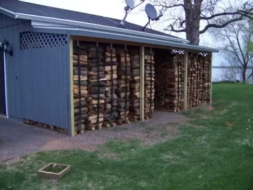

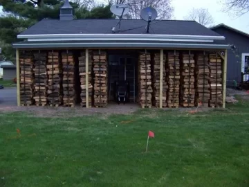

    Here is a pic of mine. I can probably hold 8 or 9 cord in there if I packed it in, but like you I wanted to get two years worth in there with enough space to get to either side, and I only burn 3 cord so that left me some space in the middle.

    Ja, I thought of just driving in T-bar posts to stack up against but NOOO, that's not pretty enough for SWMBO. I had to make lattice sides so she could plant vines to climb it.
    With your design, if you don't completely empty one side, you are putting new wood in front of old. If you dip into some of the wood on the other side, again, you will be putting newer wood in front of old. I had my wood like that originally, all rows going in the same direction. If you had three groups of rows with gaps at the 1/3rd and 2/3rd points as I will, then you have more flexibility and fewer times where old ends up locked behind new.

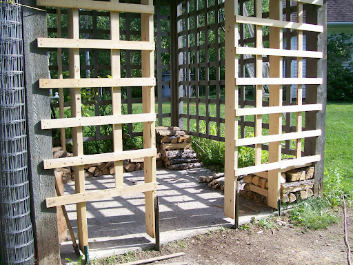

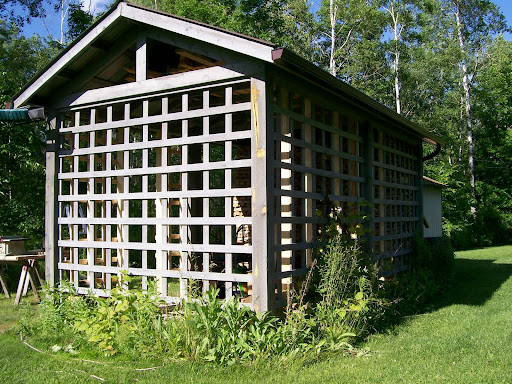

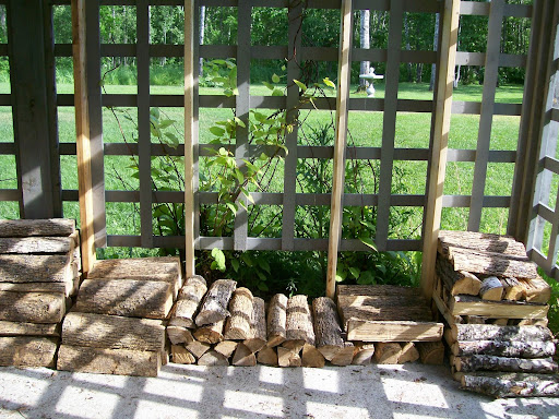

    OK, here are the pics I promised.
    This is the view of the two sides enclosed by lattice. SWMBO's plans were for the lattice to be covered in vines but the weeds seem to have taken over.
    [IMG]
    Here is the new lattice on the North side with the entrance. The row ends are ging to lean against the lattice.
    [IMG]

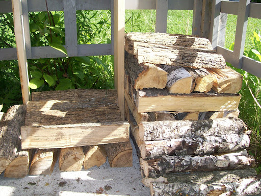

    This is the other (South) side showing how I added studs to stiffen the lattice and to act as dividers between rows. You can see the start of two rows on the right, and two of the three rows in the centre. In between, the rows will run perpendicular and lean into the other rows.
    [IMG]

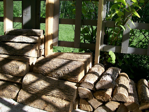

    Here is a close-up showing how the studs act as dividers and guides, holding the rows plumb.
    [IMG]
    You can also see where the bottom of the lattice has been jacked up by the frost so I need to cross-pile the first few courses until the row is high enough to lean against the lattice.
    [IMG]

    Todd, how do you not get significant snow/rain in the front of the shed? It's not a criticism, it what I've been wrestling with in the design-phase of the sheds I am trying to figure out.
  13. SolarAndWood Minister of Fire
    joined: Feb 3, 2008
    6,712 posts
    Syracuse NY
    The bottom foot or so on the outside gets a little wet on the surface from the splash of the water hitting the ground when it comes off the roof. It doesn't make a whole lot of difference other than not grabbing an arm load of it while its raining or shortly thereafter. As long as significant snow can't land on top of your stacks and go through freeze/thaw cycles, it doesn't make that much of a difference either.

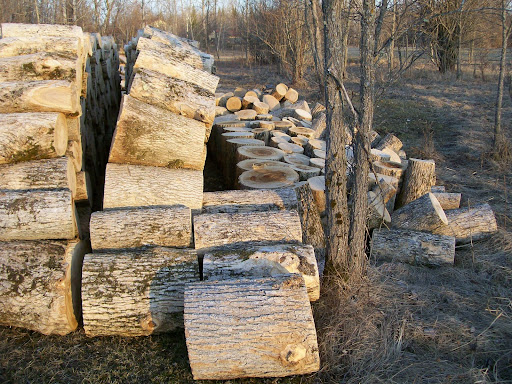

    I've been putting off splitting my last two rows of rounds, one of which the frost toppled because it had been sitting on wet ground and I didn't want to add it to my heap of drier wood. This stuff still in the round is for 2011-2012. Last year's heap is for 2009-2010 and this year's heap is for 2010-2011.
    [IMG]
    I figured this would be a good test of my modified shed to see how plumb a 9 foot tall stack of wet wood will stay after it shrinks, so I got down to splitting and stacking it directly into the far end of the shed. Stacking went a lot faster and easier with not having to cross-pile the row ends. Rain today slowed me down so I only got one cord laid up with one more cord yet to do. After that I'll move last year's heap up off the ground and into the shed.
