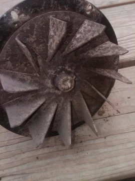

    My exhaust blower had a lot of ash and crap. I got it from the 1st owner of it that used it to heat a large basement. The basement was dry but dampish in the spring and what not. It was in good shape just cleaned off a little surface rust before repainting. The exhaust fan works good and is quiet but the blades are very corroded!
    I cleaned it up and oiled it, but do you think I should just throw a new Fasco motor in for good measure?

    Why? If its running fine and not making any odd noises? Then leave well enough alone. IMHO
  16. imacman Minister of Fire
    Agreed. Clean it up, spray the blades w/ graphite spray, and put it back in.

    Time for the dumb question of the day...What does the graphite spray do??
  18. subsailor Minister of Fire
    joined: Dec 8, 2011
    1,315 posts
    Winthrop, Maine
    Slows down the ash buildup on the blades.
