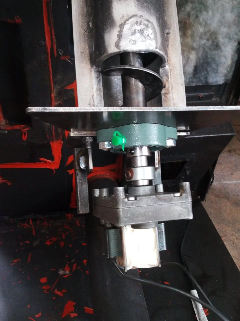

Auger Steady Bearing
Not wanting to have to replace the motor before it's time due to auger jamming this steady bearing mounted directly to the back-plate and modified motor stops seems to work fine. We also cleaned and re-greased the motors gearbox and no longer hear the motor or auger at all.
