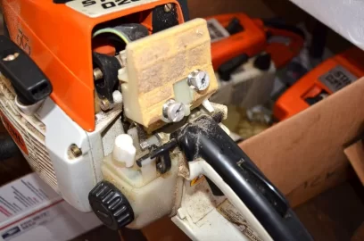

I have had this saw for a number of years and it has served me well. The cover kept falling off in the bush and last year I lost the tank vent. I have not really been able to get the correct one. The stihl dealer shows me parts catalogues and ordered a couple different parts in for me, none of them are correct. People have played around with the carb adjustments and now I can't even get the saw to start. I have a few of questions:
- does anyone know the correct part number for the tank vent? The one in the photo is not right and the cover won't fit with it on
- what starting adjustments will get me close on the air and idle screws
- what do you do with the adjustments on the tank vent?
This saw is in good shape and should work well, I think there may be either an adjustment problem or a fuel issue. I need to cut some wood!
Thanks in advance
Glenn

No, there are a couple of pieces of plastic in the way
Btw. I poured a few drops of gas in the carb and it started right up. After a few minutes it wouldn't rev up so I am assuming a fuel problem. I guess I will start by pulling the gas filter in the tank to see if that could be the problem
You might need this one. There are 4 different vent designs possible for the 026. The tall black one you have rotated 90 degrees, a short round black one, this one, and another short white round one similiar to this one. 3/4 turn on the Low speed and 1 turn on the High speed should get you started, high might need to open up more than that to run at higher speed.

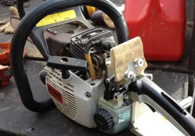

I was able to turn the vent 90 degrees. There is a slit in the vent so it fits right. Now the saw will run but at WOT it bogs down a smokes a lot
Sounds like you are 90% there, then adjust your high down a hair and see what you've got.
Start with a spotlessly clean air filter and then recheck. Saw sounds like it is running rich. Give this video a listen.
Then this one for how it'll sound in the wood.

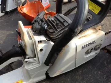

Well, I'm not sure. Since we're giving saws "feelings" here, a "clean" saw might be a sad, seldom used entity, just sitting up there all pretty on the shelf never getting worked. A happy saw might be a dusty "dirty" saw that just sunk its teeth into some fresh wood a few hours ago. My saw in the photo above is a "happy saw"! ;)
Those 026s with the split covers are kind of like a girl wearing a bikini.............. if you fool around with them at the beach, they're likely to get sand under their covers...................
