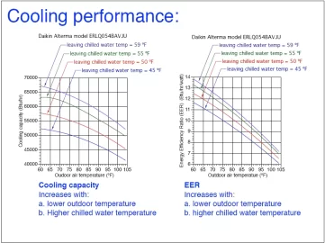

We presented a webinar a week ago on hydronic cooling and discussed air to water equipment. The thing to remember is in extreme cold conditions they kick on some resistance heat to boost. Install them in a climate where they can operate in a high efficiency mode, they are not well suited for all climates. Like any heating or cooling appliance, crunch some numbers, we give you the tools to do the number crunching in the Idronic journals. .
This graph from the webinar, shows what a Dakin air to water HP is capable of, The webinar on Hydronic Cooling is also archives at the Caleffi site.
