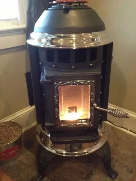

I am happy to report after changing both T-1 and T-2 sensors and adding vertical pipe to reach a 5ft rise my stove is happy and working perfectly!! I too am now happy!! Thanks for all the help guys!
Glad you got it fixed.
Hint: we love pics of stoves....especially ones that are burning brightly!!
Reactions: Mdw1219
[Hearth.com] 2001 Thelin Gnome shutting down NEED HELP!
