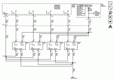

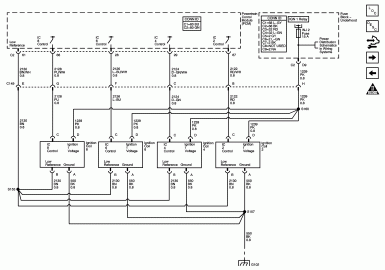

I need some help, please. So I went and got that Stickler log splitter that spins arouind on the drive wheel. I need to install a kill switch to the ignition. I'm not sure where to find the distributor, or if it even has one. It has a coil for each cylinder. Need to find a single wire, that when cut, will kill the engine. The kill switch is simple a lead wire soldered to the distributor wire, and a switch connector that pulls out. Is there a single wire to do this, where is it?

Chevy V8's havn't had a dizzy since 1999. I wouldn't reccomend playing with the wiring on a newer truck unless you really know what you're doing. Computer control systems can easily be thrown out of wack by one bad connection.

FWIW: Killing power to the fuel pump should have the same effect on that truck as the ignition and less chance of interfering with something sensitive.

I believe there is an "IGN" fuse in one of the fuse boxes.
I'd try pulling it while the engine is running to see if it kills it. If it does you can buy a "fuse tap" (something like the link below) that will allow you wire in your kill switch. This will work well as you can put a fuse back in when you're not using the splitter.
http://www.amazon.com/Tapa-Circuit-Dual-Fuse-Holder/dp/B004ZAVA78
Edit: based on the schematics Smokeshow provided maybe its the "INJ 1" fuse instead.
Reactions: smoke show
Cutting the fuel pump will not imediately kill the engine.
