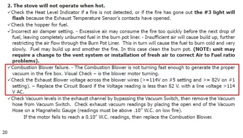

The exhaust motor stopping is strange. Luckily enough, the stoves manual has a good troubleshooting section.
https://enviro.com/custom_content/docs/manuals/C-12146 Instruction Mini A Technical Manual.pdf
