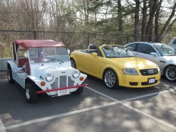

Nan's is an English (not Australian or Portugese) Moke. A whole whoppin' 848 cc! :)
At a Herb Chambers Cars & Coffee …

Wow, love both of them. The Audi, especially if it's the high output version, is a neat car. One of a few AWD convertibles. It was definitely wheeler dealers, I love that show.
Yes, it's the 250-h.p. 3.2-L VR6 engine. It is a 2004 Imola yellow quattro 3.2DSG S-Line roadster with the baseball optic interior (baseball glove-like stitching).
It was CPO car out of California in 2006 with 5,000 miles on it. Owned by the dealership owner. Had 20-inch wheels in the online pictures, but they still had the original 18-inch Audi wheels at the dealership. No way 20-inch wheels with rubber bands for tires are going to work on New England roads with potholes.
I'm not a fan of the stiff ride as it is with the stiff suspension (was previously the optional sport suspension) and optional 18-inch wheels with 225/40-18 tires. Can't imagine what the ride would be like with an inch less sidewall. :).
There were actually three very similar, low mileage Imola yellow TT roadsters, all in CA, when she bought it. Dealership split the transportation cost with us.
