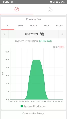

Been some awesome production the last few days here with the cold and clear skies. Yesterday my 5.4 kw system was clipping and hitting its 5.0 kw limit like crazy. My Solaredge SE5000 inveter starts clipping production at 5 kw.
March is off to a good start with almost 3 30 kwh days in a row. Looks clear, cold and sunny the next couple days as well.

I agree that spiky curve does not look right. The inverter curves I see with clipping have the top of the curve cut off in relatively straight line. If it is a microinverter or optimizer system it could just be data collection issues with the gateway.
