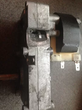

I've had my 25 pdvc for almost a decade and never needed to replace any parts. Last night we come home and its 58 degrees in the house! Find out bottom auger motor not working. I took it out to bench test it and when i got it out I noticed a hole in the bottom of the gearbox! It was the shape of the little shelf under it.
After reinstalling the spare i keep, I figured out what went wrong. Periodically the motor lifts itself up off the little shelf it rests on. It then taps lightly down. You can hear it tap or rather light clunk when operating. It was doing that for 2 years but i always thought it was just the bottom auger clunking pushing pellets.
Well, 2 years of light tapping was enough to slowly smash a hole in the gearbox.
I seem to recall a sleeve on the gearbox ( which disintegrated many years ago) well i guess thats what it was for. Temporarily i installed a piece of rope gasket on the shelf so now the auger motor rests on that vs tapping on metal. luckily I checked the upper auger motor because the same thing is happening there too! its far from being a hole like the bottom one, so i put a piece of rope gasket there too to try to prevent this again.
The stove is almost much quieter now.

Englander used to put a piece of flat gasket under each motor. Probably fell off or disinigtated. I woulda thought the clunking would have driven you nuts before the motor crapped out! LOL
It did drive me slightly nuts, but I work a lot so im not really home enough to say "hey i should take care of that clunking". I did one time a few months ago pull the auger and wire brush it thinking that was the cause but it didnt help anything and i didnt notice the bottom of the gearbox.
The hilarious part is i cleaned up that spot with a dremel and the auger motor still works! it was just the bent metal holding the gear back. It just has a hole in the case. Anyone have an old non working one they would want to part with?
JB Weld works well to patch the hole..pick it up at HD or Lowes.
10 years and no parts... It's way past time anyway. Take a piece of rubber heater hose, slit it lengthwise, slip it over the metal shelf and put a zip tie on it to hold it in place (zip tie not under the gearbos where it hits the rubber hose).

I lined the shelf it rests on with some rope gasket and hi temp gasket adhesive, seems to be working quite well.
I did open up the gearbox to dremel the hole and clean it up. there was metal keeping the gear from spinning but otherwise no other damage besides the hole in the case. i connected to a test lead and it ran fine, even under simulated load.
The grease is definitely shot. it resembles little wax balls now, which is probably why it did not leak out when hot. i did remove the grease. I am going to try to jb weld the hole shut, then regrease it and keep it as a 3rd spare. I always keep a spare auger motor on hand brand new.
