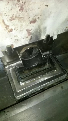

I fabricated a burn pot very similar to 99loco's burn pot. It provides a much cleaner burn and the ash is ejected out of the pot eliminating the need to scrape away pile up everyday. Highly recommend to anyone that wants to clean their stove less often.

Does anyone have a detailed plan for the modified burn pot. I'd like to try it

Sweet: did you add the trough that make the pellets drop in the middle of the pot also? My Magnum3500 pushes pellets corn out the same way but I have tried to make a few different things to get the drop out from the edge of the pot.
