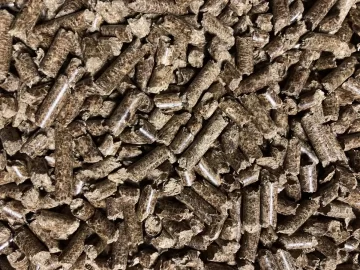

That’s the speed it’s been running at LFF 1
Heat setting 1, I added to the restrictor plate and it’s the same thing, you can see the hole where I tried to go smaller but I won’t feed any less than it is now
