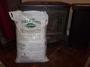

Greene Team Platinum
[Hearth.com] 25 PDVC -- Pellets that I've tested
These again are on par with Maine's Choice pellets, they get the stove up to around 350F. These also have a small amount of ash build up, but they also produce the odd clinker in the burn pot. They burn well with a white flame.

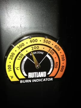

When you are stating the stove temp @ x, what are you measuring? discharge air, exhaust?

Very nice. I've burned 2 bags of green supreme, 2 bags of Team Green, I'll give Maine's Choice next week.
I've bought 5 bags of Maine's Choice after burning 1 full bag I'm disappointed. It leaves a lot of ash in the burn pot it does not heat my basement as hot as Team Greene. I've also tried 2 bags of New England pellets those seem to be better than Maine's Choice vs ash and heat. I'm going back to Team Greene it burns hotter and very little ash.
