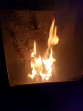

I am having issues with ash build up and I believe a lazy flame. After burning for three hours, I have a pot full of black ash. I used to have a glowing pot of unburnt lava pellets, but since plugging the bottom two holes below the burn plate, I have now just a pot of black ash.
My settings are on 4-6-1 on "D".
I am not sure if I have an air leak somewhere as the flame seems to be large. On 1-2, the flame reaches the top of the unit. I have tried various pellets and they all do the same. The stove has been cleaned in and out.
What might be noteworthy is that the largest part of the flame is typically in the rear right corner of the burn plate where the ignition hole is.
I have attached a blurry photo of my flame.
Not sure if anyone has any ideas.

I have the stove set on 1-2 and its still a lazy flame reaching the top of the stove.

I'm now wondering if my flame really is lazy, or if it's just supposed to look like it does.

As for your flame, couldn't really tell from your pic, but the only time I have a lazy flame is if I open the door (break the vacuum) or lose power (combustion motor dies).

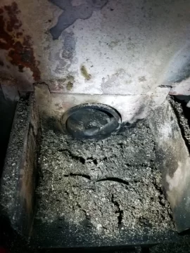

I've attached a photo of the total ash amount after a 4 hour burn on 1-1.
I have the bottom buttons at the factory settings.
Does this seem normal for four hours? Could I let it run for eight without burning my house down?
It looks like more than I have but not much more. Are you sure your combustion blower is running at full speed. When was the last time you cleaned the combustion blower fins. You would be surprised how much it slows down when it’s dirty

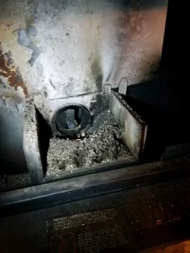

Still a lot of ash, but it's mostly fluffy now at least. I think I will decrease my pellet feed a notch or two. Seems to be overfeeding a bit.
Attached is another ash photo after 7 hours. Definitly full, but looking more like I can burn overnight for 8 hours without worrying about burning the house down.
