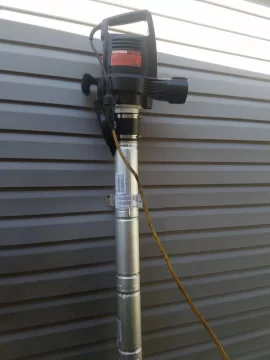

Dosnt sound right to me. Btw, the leaf blower gets all ash from around the heat exchanger. Amazing what u cant get with the shop vac. [Hearth.com] 25-PVDC Issue
