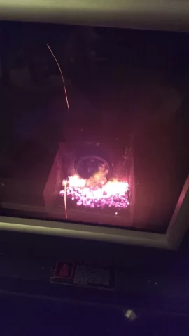

Both vacuum switches appear to be working fine so maybe it's just the low setting
Here is a picture of it on setting 2 after about 5 minutes, it does flare back up like 30 seconds later

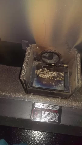

Another issue I seem to be having is that pellets are falling through the 2 holes near the auger when being pushed out causing them to sit in the bottom of the burn pot.
[Hearth.com] 25pdvc flame going out
The wear plate is installed in the first picture, I removed it for the second picture. The plate has two good size holes near the auger that the small pellets are falling through, it's a bit different then the picture on their website... but I'm guessing that is a much older one.
The pellets that fell through happened in 1-2 hours of the stove running
