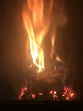

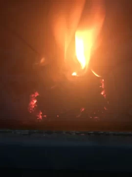

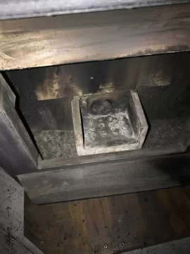

Ok when you have it running what are the heat settings the stove is on? Not the bottom 3. Of course they dont want you to mod it! Quite a few ppl that frequent Hearth. Com have and still run thier stoves more efficiently than oem design. Clean the burn plate off. Put the stove on heat 3 fan 9 and let it run for 2 hrs. Then post a picture of the flame and the burn plate loaded we can go from there.

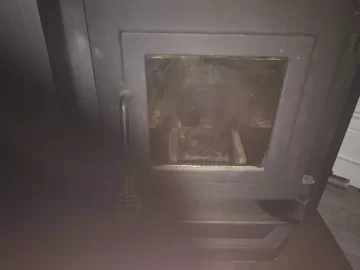

[Hearth.com] 25PDVC pellet pile up [Hearth.com] 25PDVC pellet pile up [Hearth.com] 25PDVC pellet pile up Here is the prelude. Stove is cleaned again. Also I have included a video just a sound bite of the combustion fan, it gradually gets quieter the longer it runs but still makes that noise.
A half hour in this what I got firebox is rolling smoke and here is the flame I will try to post continuous photos that way you all can see the timeline of what takes place

Was that on Heat 3 and fan 9?

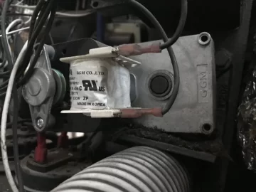

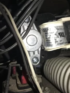

Have you replaced your auger motors at any time?
If yes, what brand and model did you use? I am thinking you may have a faster auger than designed, (2RPM versus 1RPM).

P.S. I would suggest getting a non flammable pad under the stove as it is looks like plywood underneath.

I bought the stove used so I am not sure what’s been replaced or wasn’t has been replaced. Up until a few days ago I’ve never had this issue.
That pad underneath is a cement board stained and stamped.
