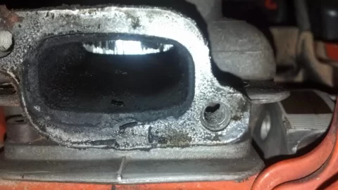

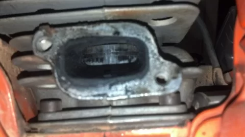

I pulled the muffler. The piston shows significant scoring.
  • [Hearth.com] 29 Years and a big screw up - NEED HELP
As expected. Time to pull the cylinder.

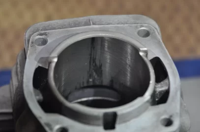

Man that sucks, but it could happen to any one of us at anytime. I almost did it before. I thought I had mixed the oil into the gas can already and caught myself before it was too late. I'm curious to see how the cylinder looks if you wouldn't mind posting so pics. Some emory cloth and WD-40 and you may be able to salvage it if the scoring is not too bad.
Well, I've finally got the process figured out. The cylinder (42mm) had some damage (picture attached) but the small engine shop said to try sanding it with emery cloth. The cylinder now is smooth and I hope I did not remove too much material to mess up the compression. I have ordered a Meteor piston, rings, gasket, and I hope all of the other needed supplies. Now it is time to try and remove the piston pin (hopefully that will come out easier than what I expect), take off the piston, and wait on the new one to come in the mail. Well, what have I learned.....ALWAYS CHECK TO MAKE SURE YOU HAVE OIL IN THE GAS!
