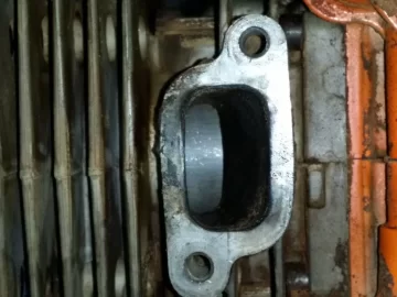

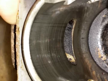

I'm not sure here is a couple pictures of the piston thru the exhaust port. I thought if the crankcase was leaking that it would rev uncontrollably. [Hearth.com] 359 [Hearth.com] 359
That piston doesn't look great, but it doesn't look terrible either. The random bright dots are odd.
Is the decomp valve working properly?
I think so it had a lot of carbon build up. The pictures didn't show it but there are horizontal lines from top to bottom on the piston. I think that is what the bright spots are.

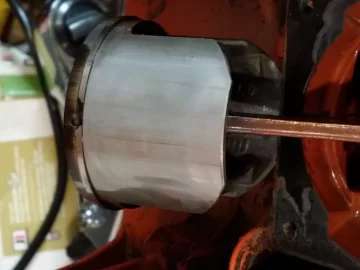

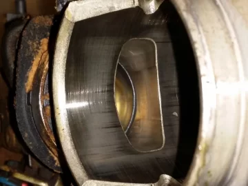

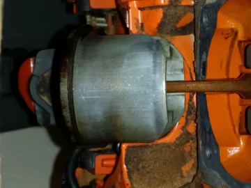

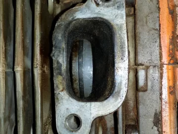

[Hearth.com] 359 [Hearth.com] 359 Here are pictures of the piston and cylinder.

View attachment 141664 View attachment 141665 Here are pictures of the piston and cylinder.
When you run a finger/fingernail over the cylinder do you feel any scoring? If not it may just be a case of putting new piston and rings into it to get it back to normal. If there is some scoring, it may be time for a new cylinder/piston.

There are a couple places where I can feel scratches on the the piston and cylinder. I'm going to order a hyway cylinder kit.
i still think you should do a blowdown test. that cylinder and piston look good from where I'm sitting.
