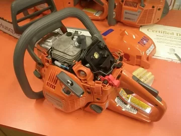

Have any of you Guys or Gals had any problems with dust getting into the carb./eng. on the Husky 450?
I have had the saw since new 1-13-10.
It looks like the filter is not tight to the carb housing and it is leaking bye.
I now have a saw that has dust burned threw it.
It is under warranty for another 10mo.
I called Husky and the were no help.
What to do?
Run till it dies?
Thanks Neal
  • [Hearth.com] 450 e Husky
Updated with picture.
This is about a half tank of fuel used.
The upper left corner looks to be the area that is leaking.
fyrwoodguy said:
looks like the lower left corner,could be the culprit. make sure your airfilter has no high spot(s) to allow dust.
a correctly sharpened saw chain does not produce fine dust. are you cutting dry,hard wood ?
Any saw will produce small fine dust even with a sharp chain. May look like all chips but that dust is still there just not as heavy. You can see it in high winds rolling off a saw.
I am picking dust out of my eyes all the time. Goggles help but that dust can still get in there.
Can you put some grease where the filter is leaking? Think I've seen that suggested for a leaky filter.

That may work well in a couple of ways.
Looking at fyrwood guys pic of the filter, I think that is the same style or very similar to a 262XP...... think that is where the idea came from. Put a little layer of grease all along the bottom edge of the filter and then pop it back on the saw.

Thanks.
I will clean the saw up and try the grease.
I did not see any high spots on the filter but I will look closer.
I have been cutting black locust and it is dry and hard except at the base of the stumps (18"to 30").
