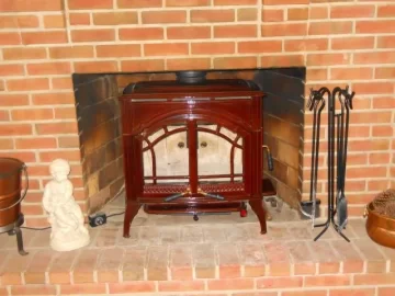

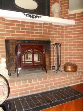

Here's the pictures
  • [Hearth.com] Cumberland Gap by Quadra Fire
Nice looking heat machine. Did you get a fan with that?? If not, you may want to consider it.
That is a handsome stove. It looks great in that setting. Thanks for posting Jeff. Did you consider rear-exit vent to a 90 so that it could be a bit more forward on the hearth? That would help heat output and access to the side door.
I could pull the stove out 10 more inches but the boss liked it better tucked in.I would like to try the side door sometime but it seems to burn better for me loading n/s.
