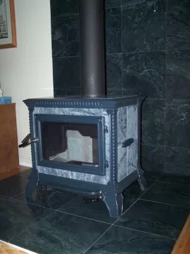

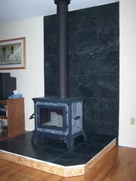

Saw a reply above asking for pictures of soapstone tiles with stove. Here are a couple photos of my setup. Hearthstone Heritage stove with 1/2" thick soapstone tiles for hearth and back wall. The hearth is raised with wood base, then layer of micore, then 2 layers of 1/2" cement board prior to thinset and tiles. I still need to finish side trim with oak to match the floors, but you get the idea. Can't comment yet on how the soapstone surround absorbs/radiates the heat because it's all new (haven't even had break-in fires yet). By the time I finished install and inspection this spring, it was already too hot to use. Cooler nights on way, so pretty soon.

Wow! Looks real nice Jim.

You must have oiled or waxed your tiles looks great, and looks like we were thinking alike, If they don't retain a little heat they sure look good. I oiled mine once and they got dark like that. Nice Job.

Not to derail this thread . . . but I had a question for those folks who built the hearths out of soapstone . . . a very cool (and good) look by the way. How has the stone held up to scratches . . . I only ask since I know soapstone tends to be a bit "soft" and from past experience know that it can scratch easily.

My soapstone hearth is only 5 months old, so too early yet to comment firsthand on longtime durability. The only marks on the tile thus far are from stove installation. When we set the stove on the hearth, we got as close as possible to desired location, but were about a 1/4" off on one side. The feet left slight marks in original spot when we lifted and re-positioned.
That being said, I did do a fair bit of research on soaptone before building as I also had similar concerns over wear. There are many varieties of soapstone, each with different hardness properties to go along with the different color shades and patterns. Believe this has to do with geographical locations and mineral content where the stone is harvested. The soapstone I went with is called Beleza, and it is reported to be one of the harder varieties (also one of the busier, some are almost solid in color). The supplier I bought from had a bathroom in their showroom with floor done in same tiles, and it looked fine (the shine on the tiles had dulled a bit from use and mopping, but as previous post noted the tiles can be waxed to bring back shine if desired). Many posts can be found on soapstone slab kitchen countertops, and the wear and tear associated with those. If a scratch is deeper than acceptable, it can be sanded out and the stone polished basically back to normal.

Cptoneleg and Jim E . . . definitely keep us informed on how the soapstone hearth holds up . . . and if it is able to retain the heat like a heat sink and release it after the fire has gone out . . . I really like the concept and the hearths look stunning.
