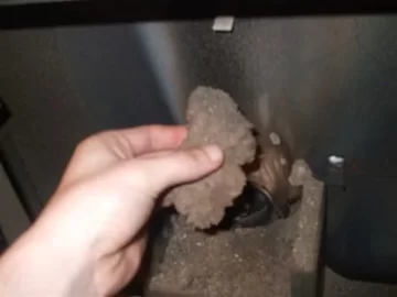

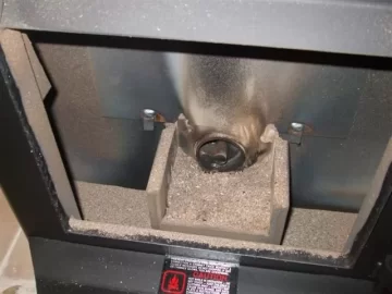

Hey guys,
I attached some photos of my burn pot after bruning 30-40 pounds of pellets. Seems to be a lot of ash in my burn pot, doesn't seem to be flying out into the sides. I have a couple clinkers in there too as you guys can see. I'm burning Corinth pellets, my stove was manufactured 10/08. I have it at the factory settings for those three buttons across the bottom...6-4-1. I recently bumped it down to 5-4-1, just to slow the rate at which my pellets are kicking out as I seem to be burning a 40 lb bag of pellets in 15-18 hours.

hmmm not sure being my first year too but looks like a little to much ash maybe more air is needed to puff some of those ashes over the edges?

The amount of ash seems to be normal from my viewpoint. I have an 06 PDV, which is the 2200 sq. foot model. I've burned it just about 2 full seasons, and at least once a day I just hit the off button and let the fire die down and then scrape the burn pot with an old spatula and dump it off to the side. Works well, takes less than 5 min from start to finsh.

That is a lot of ash for 1 bag being burned. There are 2 possible reasons for this, pellet brand or air flow. If you're burning on low, setting 1 or 2, you will need to adjust the LFF and LBA settings for different qualities of pellets. I believe I read on this forum that the Corinth brand were high ash, but you may to search to be sure.

From my experience I'd say that is a bit more ash then I am used to. It looks like the ash is half way up the lower auger. I shut it down once per day and dump the burn plate, reload pellets. I also believe the outside air is mandatory. There is a big difference in ash between pellets, just like a difference in heat. Try another brand if you can get a bag or two to test. You could also play with the three trim settings. It's not rocket science, just keep a close on on the changes and remember where you started. Eventually you'll zero in on what works. Have fun.

for starters that is a bit much ash. lets see if we can dial that back some, first , get that oak kit installed mandatory isnt a word we use lightly. here's why, if you are running with house air these things are happening 1. you are pulling about a quarter of a room full of air out of the house per minute, this air must be replaced or a high amount on negative pressure will result. this means that every little leak in your house will be magnified as air is sucked in by the vacuum created by the removal of air. pulling outside air means your house is notattacked by these leaks as you arent pulling this air out. now take that a step further, as air warms up it expands this creates Positive pressure which pushes against the same leaks so your house stays warmer in places not near to the stove as cold air doesnt get pulled in.
2. the stove will burn cleaner negative pressure over time will reduce the amount of available oxygen pulled through the fire. this results in a dirtier stove and lower heat output. it also soots pipes and can cause sooting on the outside of the house on exterior walls near the exhaust.
3. and most important, if the unit has run long enough to reduce pressure in the house and a power failure occurs the neagtive pressure could overcome the natural draft of the vertical in the flue and cause the unit to back vent through theintake causing smoke in the house. we at ESW try to avoid smoke intrusion as its simply not pleasant.
that said , lets look at the consumption rates , they are a bit fast look at the low fuel feed button , when you press it you get a 6 in the blower speed , lower that setting to 4 and see if that doesnt move you to about aq 24 hour burn. as for the ash buildup , increase the low burn air to 9 and see if this doesnt help that some for ya.

The amount of ash looks pretty normal to me with some pellets. Right now I'm burning some that are ashy and my pot looks very similar to yours after a bag. Funny, while these pellets seem to produce a lot of ash it doesn't make any clinkers. I don't like clinkers but honestly....they are easier to flip out of the pot than fine ash. :wow:
Made the changes to my stove last night, I stayed up until around 1 watching it. Went to bed with the stove set on 2-4 and the settings on the bottom at 4-9-1. Definitely fixed my ash problem as I have next to no ash in the burn pot this morning...on the other hand I had next to no heat coming out of the stove. I'm going to try changing the lower settings to 5-9-1 tonight and see if that puts out a little bit more heat...What do you guys think?

You'll need to play with these settings to get it where you want it, (need it to be). Whenever I try a new brand changes usually need to be made to these settings to get a good burn.

That, pictured on the left is a clinker? I just thought that was just a clump of ash. I always pictured a clinker was rock hard... almost like a piece of coal. I've had those things before... do they break apart really easily, sometimes while trying to pick them up. similar to when you get a clump of sugar in the sugar bowl in humid weather?
