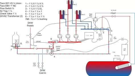

I am looking for a supplier for a TACO 007-VSSS-5 IFC Setpoint circulator for my in tank heat exchanger installation. The variable speed pump control keeps a setpoint mix (I am setting at 130F for radiant). My local plumbing supply can get it but it is a 4 week lead item. Anyone know of a good supplier who may have it in stock? I have added my digram FYI. Alternatives are welcome.

What are you using for your in tank heat exchanger? I had a 42 gallon galvanized steel tank in my storage tank to heat/temper my DHW but it rusted out. I put a 200 foot coil of 3/4 pex and that does nothing at all to temper the cold water.

We are using a copper finned coil (4" diam, appx 30" long) from AHONA. The standard coil is rated at 6GPM 55 degrees inlet and 140 degrees outlet so we should have plenty of water to mix with 110 inlet temp versus 55. It is mounted on a 4 inch plug which fits the 4 inch port that AHONA welded on my tanks when I bought them. My maximum flow rate requirement is 9 GPM with a 20F delta T (110 -130).
