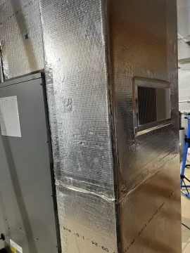

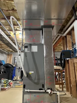

Yes - thanks for asking. This is a place where I could use any advice. I am not in the industry, but I am an engineer who has needed to learn quite a bit about static pressure as multiple companies, install techs, service techs, and sales folks have hardly recognized the potential that I had an issue. In their defense, they were replacing a 5-ton system that would have appeared to operate correctly with a same capacity unit, so there probably wasn't much to tip them off.
Details of the system: 5-ton (target 2000 cfm air flow), high ESP (up to 1.0"WC) air handler.
First issue I had was soon after startup. I had installed a standard pleated filter in the 1" slot beneath the air handler. Same filter (think it was MERV 8, nothing crazy) I had been using on the old system. At that point, I noticed really low airflow from the vents in the house. The filter was getting drawn very tightly against the drain pain of the coil as well.
Contractor recommended using a lower restriction spun fiberglass filter instead. I installed and situation improved, and I also became aware of the speed settings on the motor which could be adjusted to match ESP. Contractor had not made any setting changes to the system. Bought myself an inexpensive manometer and began measuring total external static pressure (made all the proper considerations for where to measure and filter in/out of system). My measurements showed moderate static (0.4-0.5"WC) but very low flow. I was seeing 1400 cfm with both zones open, and flow would drop to 1200-1300 cfm with only a single zone calling. Again, this is a 5-ton system where I was expecting closer to 2000 cfm of flow. So I bumped it up near the upper end of the static range (0-7-0.8"WC) and flow was better, nearing 1900 cfm with both zones calling, 1700-1800 with only a single zone calling.
Things ran well for a month, then one morning I heard compressor running but no fan. Pulled the cover on the air handler to find the indoor fan flashing a generic fault code. Contractor came back out, said yep must be high static, and cut the single 8x10 (or so) register in to the return line in the basement.
I've since tried sealing the vent and have had the blower motor trip off again. Funny thing is, it runs well for a month or so, then just suddenly has an issue. Breaker reset always brings it back to life. I'm sure the fact that I'm seeing 40 degree temperature differential at times (leaving air temp of 108 degrees) doesn't help with keeping the fan cool at higher static operation.
I've remeasured and readjusted pressures and airflow. Right now I'm operating in the 0.6-0.7"WC range, and I'm getting 1800 cfm with both zones calling and 1500-1600 cfm with only a single zone. My feeling has been this is "close enough" and a decent compromise, but again, it's relying on having the supply and return to the basement both open, creating the bypass.

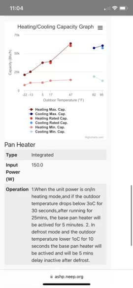

House is about 3300 sq ft in central PA (zone 5). I have heat strips completely locked out in the controls; never use them, don't have a need even when we are at 1 deg F.

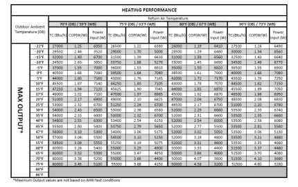

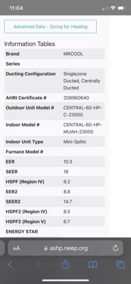

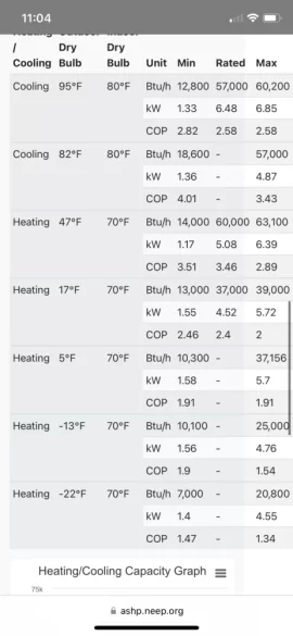

Being a variable speed inverter heat pump, it is supposed to have good performance down to lower temperatures, at least better than the two-stage system it replaced.
Included performance charts if that helps.

Did you tell us how big the return (and thus 1" filter) is?
When I had a 4 ton ASHP system put in the yokel installer put in a too small return with a see through floss filter, and told met to avoid pleated filters bc they 'had too much resistance'.
That return was loud as heck, would whistle even at full flow. The return was louder in the house than the handler in the attic.
I looked up the specs and there is a minimum return area per ton (or cfm), that his return was about 30% under.
I called on him to upsize the return (requiring him to build a new custom plenum), and withheld my final payment. He asserted that this was the return size that he always installed on 4 ton systems. I showed him the engineering spec docs, and he relented. He build a sturdy but leaky plenum from sheet metal, and I paid him. And then I airsealed his plenum. This is what you get with the low bid, I suppose.
My new return corresponds to the largest retail 1" filter size, 24x30" IIRC. It is still quite loud. And it is just at the engineering minimum, and I think my system runs at 1500 or 1600 cfm.
Given the above, I don't think it is possible to have a single return serve a 5 ton unit and be in spec for cfm/sqft. It would need to be 30" by 30" or larger.
So my guess is that your previous system had a too small return and plenum. And so your new system does too.
So even though new units are designed to work with 1" filters (they really are, and the high MERV filters from 3M are now lower friction than old MERV 8 filters)... if your return area is too small due to install/design defect... then THAT is your problem.
Give us some details on your return.

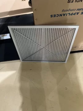

Some answers to these questions:
Dimensions of everything are on one of the images above. The angles represent length, width, and depth. I am guessing the return drop is undersized for 5-ton (2000 cfm) flow. It's about 27x12, and that's duct-board, so I think inner dimensions take at least an inch off the exterior dimensions. With the trunk lines being of similar size, I'm not certain if upsizing the drops and plenum around the air handler will help, but I'm no expert for sure.
The filter is about a 23x20, but since it sits right at the opening to the drain pain of the coil, it's effectively filtering through a 20x20 area. I've since learned that the 1" filter openings are also not necessarily appropriate for good filtration; external filters should always be considered.

OK. I think your duct system is designed for higher pressure (thus your high SP blower) than conventional, so your duct trunks are a bit smaller than mine (a 4 ton system).
I won't say that's a problem, just different.
But you can google up the specs on pleated filters (like the 3M filtrete) regarding max cfm, and expected static pressure at max cfm. Then you can either use them with that arrangement (use the working area of the filter if it is smaller due to install), or not. And you can decide if the static pressure is too high for the blower, or not.
My low SP blower has no problems with MERV 11 filtretes, so it would be ironic if your high SP blower can't handle them. These were engineered to be lower SP than older pleated filters with poorer filtration.
I have the filter holder on the entrance to a single central return (a common retrofit configuration).... I don't have returns in many rooms. I like this bc it means I am not collecting dust anywhere in my ductwork. It all looks shiny and clean inside when I look, after 15 years in service.
If you have only 1 or 2 returns, you might consider installing filter holders there? If you wanted MERV11 or near HEPA whole house filtration.
Definitely agree with what woodgeek is saying, but if your system as-installed is having airflow issues then I do think it's worth trying a less restrictive filter. Anyway the filter isn't meant to fully clean the air, just protect the blower/coil from dust which you can do with a MERV 2. If you want higher level of filtration for health reasons, then you can get get a standalone air purifier or do the necessary duct work to make your system happy with the higher filtration level.

View attachment 308994 View attachment 308995 View attachment 308996
@EbS-P Can you help me understand what you were seeing in the data? Nor sure if this is the equivalent of my system, but I'd like to understand what you saw that led you to the recommendation to run in 4-ton mode. Thanks.
Edit:
I do believe this is the link to my exact system:
Edit:
I was looking at the COP. And how it changed with the the output, max, rated, min.
I’m not sure how the on board logic works but it’s probably targeting a coil temp (hopefully), while measuring return supply and whether thermostat is still calling. It may have a set ramp rate. I don’t know really. My guess that it is the simplest cheapest logic they can make function. So it’s likely that you have never needed the last ton of capacity (again just a guess). The higher static pressure may result is lower air flow which the system might not be aware of. It thinks it’s seeing 40 degree delta at 1750 cfm when it’s really getting less so if it’s running if it’s coil temp sensor it says is putting out enough heat.
All of this is just guessing if it’s not measuring coil or supply or return temps it has no way of knowing the actual heating demand and will follow its program untill the thermostat satisfies. Dampered zoning is just problematic. I am avoiding it completely with a new ductwork install.
Which circles back the to most efficient way. My guess it is to run at the lowest compressor output and fan spend at 100% duty cycle. Then if that doesn’t satisfy after X amount of time it increase the output a bit and run it for X again. But the X should be a long amount of time. Like 30 minutes or an hour. But this might not be comfortable. Especially if you use a set back routine. It would take too long to come back up to higher set temp. But if you are like me trying to eat every ounce of efficiency out I increase the thermostat 1 degree at a time to keep running on only my first stage and some my strips never kick on. (I can’t lock them out). I Think that the reduction in static pressure saves energy but it might not.
At the end of the day spending the money saved on a system like this (vs an higher end heatpump) on air sealing and insulation will give much bigger payback than trying to squeeze more efficiency out of the unit.
Thanks @EbS-P .
What you described is what I had expected, after reading up on the strategy the Bosch IDS / BOVA units use. I would have thought control for this system were similar. But I honestly think the Gree/Mr. Cool/Gree setups don't control to a target coil temp. Or at least not one that isn't 130 degrees+ in heating. I think they strictly ramp up over time, and that ramp rate may be affected by parameters like line temps and ambient temp. I have never seen this unit modulate down; it always ramps up to what looks like max (7000W) and hold, no matter how long it then runs.
Ideally, in my opinion, it would modulate to keep a set coil temp. If it finds it has ramped too fast and overshot the coil temp, it would back off on compressor output. Similarly if air flow were low, coil temp would rise, and it would reduce compressor output. Based on my observations, this is not the way this system is designed to work.

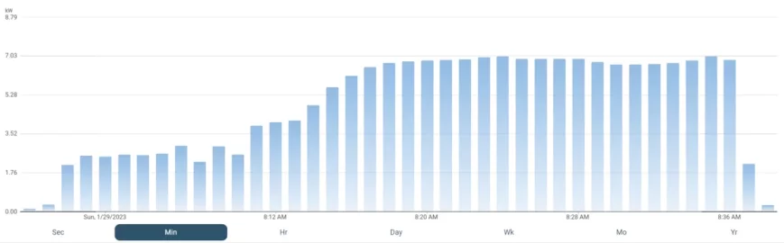

Attached is a pretty typical power consumption curve for a setback recovery (from 65 to 67) on a 27 deg F morning. Each bar is the average kW used over 1 minute of time. Have never seen a situation where the power consumption modulated down before the setpoint was reached, regardless of how long it has run. It always plateaus at max.
[Hearth.com] Optimizing operation of heat pump for efficiency
I use a 20x30 filter for my 3 ton system. FWIW
Our 3 ton HP system has 20 x 25" air filters. There is a 1" prefilter and then a 4" Merv 13 box filter. It's an Am Std. Heritage 16 system with a variable-speed DC air handler. Static pressure has never been an issue.
