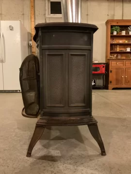

Here are the close up pics of the old stove, for those who asked.
We’ve never used it, as per warnings from the chimney sweep.

Is there a safety label anywhere on the stove? Would have mfg info, date of mfg, sometimes clearance drawings/specs, and agency that performed safety tests?

What's the chimney sweeps cause of alarm? Granted it's not a modern stove, but what's unsafe?
Interior pics? Are the panel joints good?
The whitishness suggests overfiring.
It was about a year ago at this point and he gave us a long explanation over the phone. I don’t really remember the details. We’ve never had a wood stove before so the details didn’t mean a lot to me a the time.
