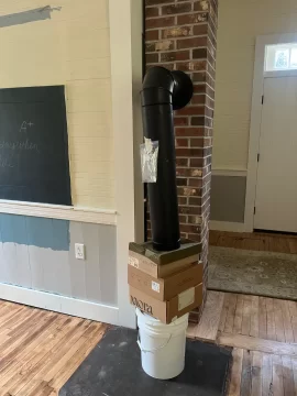

I'm looking for a wood stove that can be my primary heat source and would like some recommendations. The house is old and uninsulated (except the roof), tall ceilings, and open 1500 sq ft floor plan (both first and second floor). There are no risers on the stairs going up to the second floor, which allows for more heat to reach the second floor. There's a heat pump on the first floor below the stairs that's currently the primary heat source, that I'd prefer to be the back-up since Maine winters regularly dip below ideal temps for higher efficiency.
The house currently has a brick chimney (located inside the house) that was most recently used for a propane stove. See pic for current set-up. I know I'll need to get the chimney re-lined, but otherwise looking for a stove compatible with this set-up.
I've researched catalytic vs non-catalytic and prefer the catalytic for the more even heating and longer burn times. I'm intrigued by the soapstone for the soft, ambient heat, as long as it can still adequately heat the house. The makes/models I'm considering are:
- blaze king ashford
- hearthstone heritage
- vermont castings intrepid (although it seems like it fits up to 14" logs which seems a little limiting)
- keystone 204 soapstone wood stove (serial number 4946, looking at a used one)
Open to other brands and models. If I'm buying new I'm hoping to spend $4,000 or less. Been looking at marketplace too for something used.
This is my first wood stove, so I appreciate any suggestions and input!

If the $4000 includes relining, it might be tough.
Make sure you use an insulated liner for safety and code compliance.
Can you sketch the floorplan?
Do you know how many btus the heat pump supplies to keep the home warm?

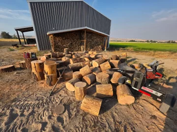

Everyone here will encourage you to get a few cords of wood and make certain it's dry with an inexpensive moisture meter.
But, also build a kick a-- wood shed!

The floor plan is a total of 1500 sq ft. so 750 ft per floor. On the first floor the bathroom is the only room with a door, the rest is open. Upstairs is the same. Ceilings on the first floor are probably around 12 ft., 8-9ft. on the second floor.
Not sure about BTUS, but it's a single heat pump unit and runs pretty constantly when temps dip to 40s at night.
